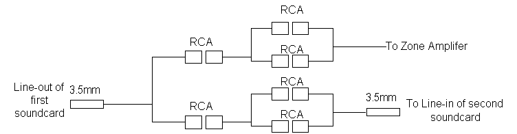

Is this the guide your talking about? Even if you get it to work, the problem with attempting to share a winamp between two cards this way, is that they will always be slightly out of sync from one another. Eventually, as the one card drifts too far out in timing, the other will faulter...meaning the audio will skip and sputter to sync the two outputs up again. I was using this in ZoneSkin4, but opted away from this route in my latest ZS5 (due out in a week or so), because of this very reason.
With what you want to do the best your going to achieve is two seperate independent zones. If you want to sync one zone to the other, what you could try (and I'm not gurenteeing that this will work, as I haven't tried it) is to use a "Y" off the audio out of one card. Send one "Y" stereo pair to your zone amp, then send the second "Y" stereo pair to the line-in of the second sound card. Then mix the line-in input to the output of the second card to its zone amplifier. This should at least allow you to play multiple zones in near perfect sync. This sort of setup just isn't versitile in any other sort of way though.
Below is an example of the interconnects required between the two soundcards.
