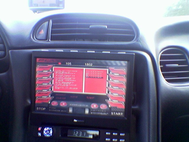

Flight recorder can log any xl variable (or more generally Xtalk variable) into a log file. Flight Recorder requires beforehand set xt-environment with xthub and needed devices. If u r new for xtalk Look xpert thread how to set everything up.
U fire up FRd with following commandline:
- Code: Select all
FlightRecorder alias configfile
where "alias" is xtalk name for this particular instance of the device. and "configfile" is the filename of ".ini" file without extension which tells flightrecorder what to record and where. Ull need to type this file by hand and instructions how to do so will follow.
as usual u can put the above line in your "autorun.ini" file to be launched as pt-environment is brought up.
Before u run program, however, u need to manually create "logs" directory within your PervWare folder. That is where FlightRecorder will store all its recordings.
When flightrecorder is launched it will start automaticly in recording state.
