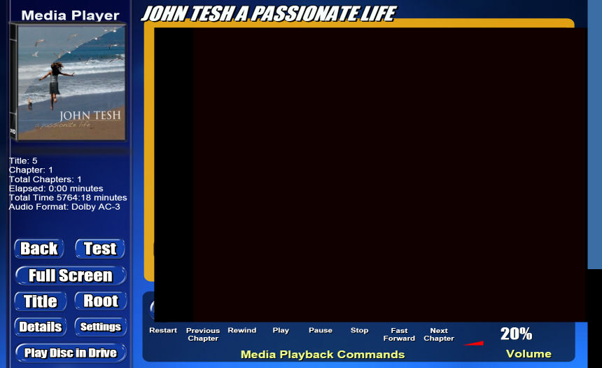

I'm sure this is NOT a XL issue but an ATI one. Maybe someone can shed some light. Version 3.
Have Cyberlink Power DVD 7.3 Ultimate. Vid works fine. Have Vista Graph File for Pwr DVD 7 and AC-3. Have ATI 2400 HD series card with component out and Catylist Control Center.
Had video on ver. 2 until I substituted a touch screen for monitor 2. Was playing with cloning to control XL. No good because of diff screen shapes.
I could never get the internal player to display video after that. I'm back in extended desktop mode.

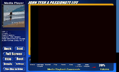

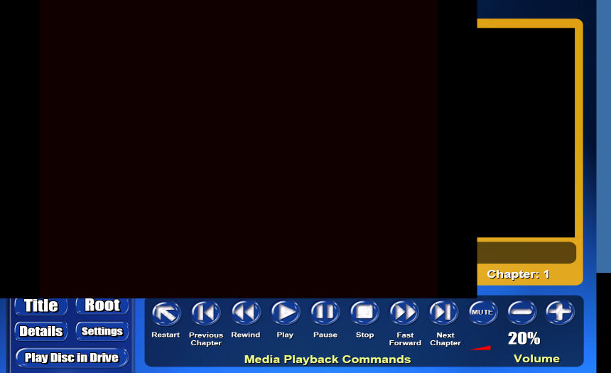

So, I decided to jump into XL ver. 3 and try to get video back. I can get the video to play fine in ATI theater mode on monitor 2 (letterbox). But, I just have black screen in the player space on my 1680 x 1050 monitor 1. Audio is fine. If I hit full screen, you can see that the black area doesn't fill the screen. If I then hit settings, I still don't but the black area moves. I've been playing with this on and off for over a month.
Anyone? The 2 pix are in reverse order.

However, I just installed the Catylist and card driver dejour and I now have the movies playing in the player on the DVI/HDMI screen. Finally!
The non-full screen image is very small - maybe a 1/4 of the player are and offset toward the top and left. When I hit full screen, it's like the second picture in my first post but with video. It's larger but offset toward the top and left.
