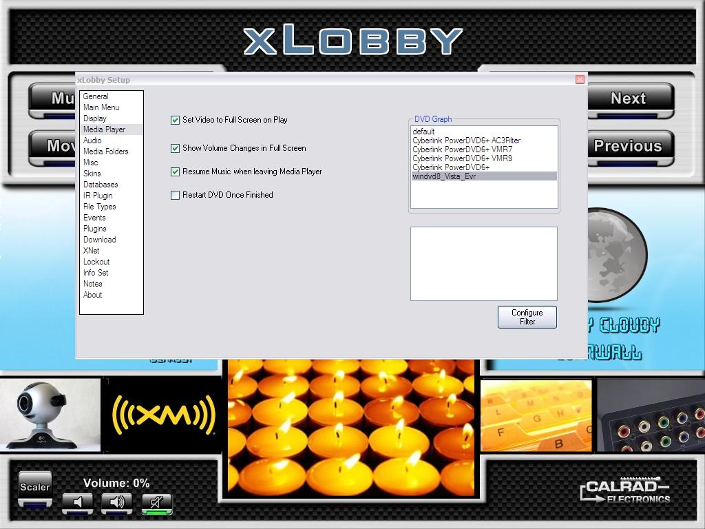

Postby wesblack on Sat Aug 16, 2008 3:31 am
Are you selecting your graph file from F2, media player.

Postby lar282 on Sat Aug 16, 2008 7:41 am
yes Wes I am selecting through F2, and thats when the dvd wont play at all.
Seems like XL is using the merit system if no graph exist at all. if then I choose to configure filter during playback I can see what codec is used. but If I do the same with my graph, nothing happens when I press configure filter. My graph must be wrong somehow. I got it from connection to remote graph when playing a dvd through windvd using graphedit.
