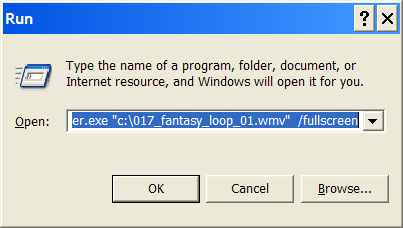

I tested this in XP. What you do is click on start - at the bottom of the menu on the right you will see "Run". Click on that. Type in the windows command like: wmplayer.exe "c:\017_fantasy_loop_01.wmv" /fullscreen
Your window will look like this:

Thank you! It is a problem with WMP11. I have no way of testing it on WMPC, WMP9, or WMP10. For some strange reason, as soon as you open any document with WMP, in fullscreen, or windowed, it pulls focus off the window.
This means you have to click it to even ALT+ENTER (fullscreen) or ALT+F4 (close). It is so damn annoying. I just went and downloaded HIP, and have started toying with HIP. If I can get HIP to work seamlessly with ZoomPlayer and my MCE remote, I'm fine with it. To hell will WMP11.
