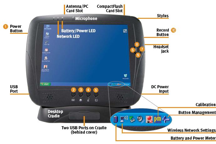

1) Does anyone use a DT366? I think it looks perfect for a touch remote. Cheap too.
Looks good to me:
