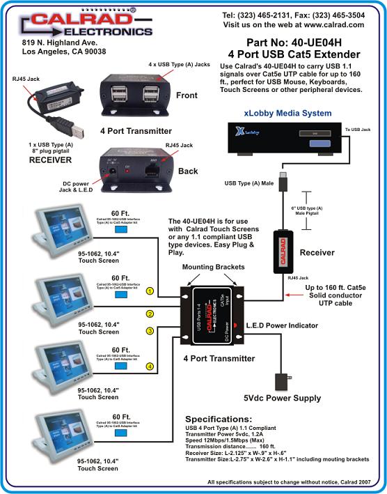

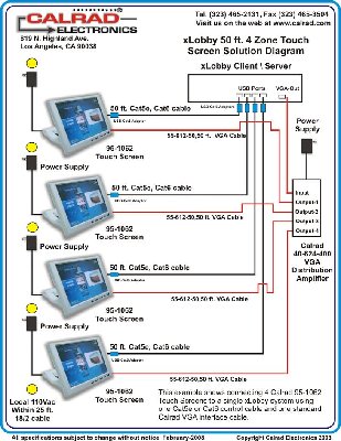

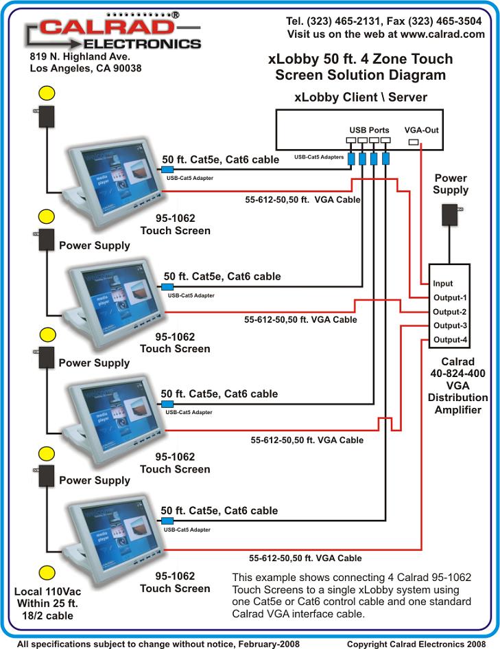

Calrad has several VGA distribution amplifiers. You can hookup multiple touch screens to a single xLobby using either a USB or RS232 style touch screen.
40-822-400, 2 Port, 400mhz VGA Distribution Amplifier
40-824-400, 4 Port, 400mhz VGA Distribution Amplifier
40-828-400, 8 Port, 400mhz VGA Distribution Amplifier
40-UE04H, 4 port USB hub over Cat5e.
