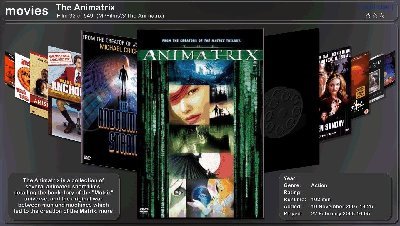

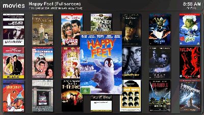

Postby S Pittaway on Fri Feb 29, 2008 11:33 am
depending on the version of xlobby you have the answer is sort of :)
if you have a version new enuff and you only want to show a cover you can the cat offset functions to simulate it, create a text vbox and set its text to category>xyz>cover>offset>angle and it will shiow teh appriopriate cover, you can then position them as needed (eg to show the prev mmoive cover the text is category>movie>cover>-1>0)
here are two layouts i have knocked up using this
