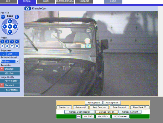

I'm using the IP cam page which comes with XL to monitor my IP cams at my vacation home.
I want to add non-camera controls to that screen.
I threw an I-frame together and tested it in IE 7 with the cam's default servlet page.
See pic.
I'm challenged for my user/pw, I enter them and it works fine. Operate the garage door, lights, etc.
But, if I try the control page in XL's browser, the buttons work but nothing happens.
Is this because of the user/PW requirement?
If so, is there a workaround?

Clarification. I forgot to mention that the control page's user/PW dialog does NOT appear in the XL browser.
It opens by itself but doesn't fire any events.
Hence my question.
