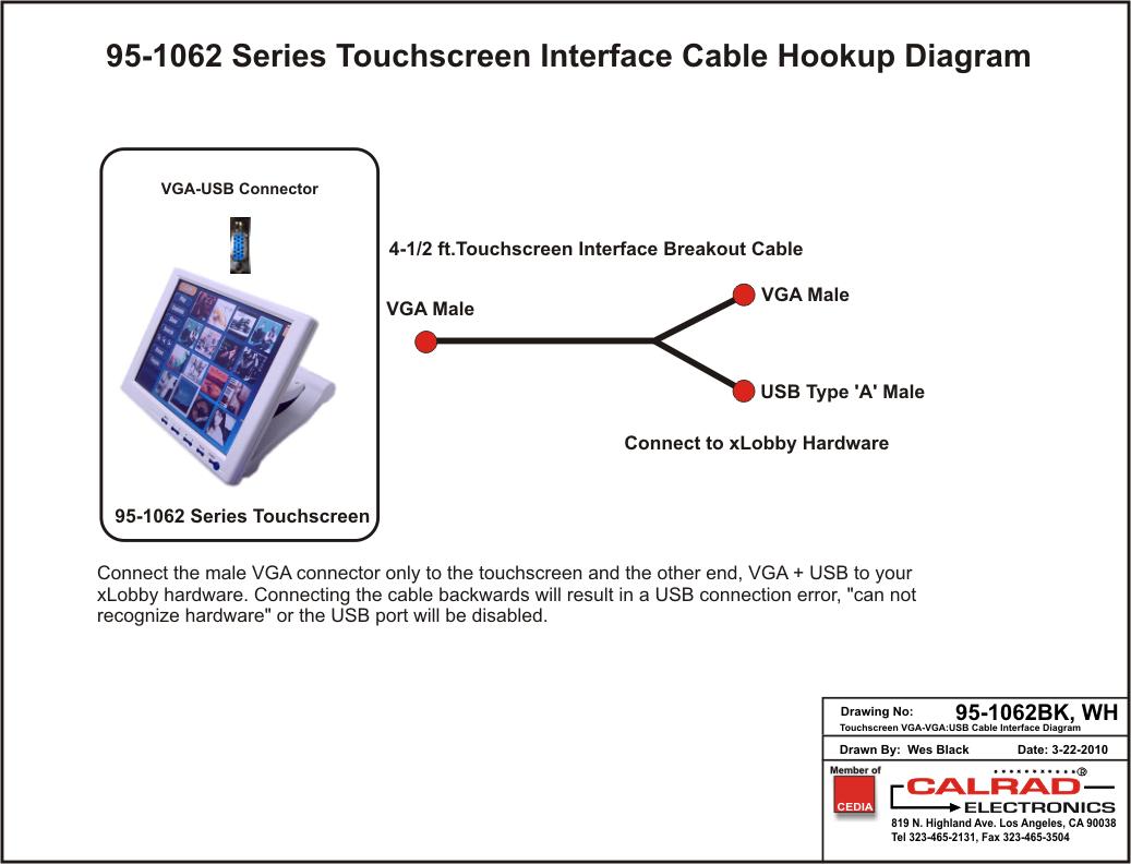

hey everyone,
anyone using the calrad touchscreens, i cannot get the usb to work on any machine, i tried all my computers, every time i get usb not recognized.
even my samsung Q1 gets USB not recognized.
can anyone help, how did you get your touchscreen working?

You obviously installed the driver correct ? Also the VGA cable goes directly to the touchscreen and the other end VGA-USB cables to your xLobby. What version of windows is this ?

found the issue, the problem was between the keyboard and the chair.
ID10T error, i was actually one of those people i always make fun of after i get called for tec support.
i had the cable backwards, i will now crawl into a hole and be quiet.

Here is the diagram that should have been inside the box. Sorry this caused so much confusion. :D
PDF File Link:
xLobby touchscreen cable setup.pdf
(95.81 KiB) Downloaded 270 times
