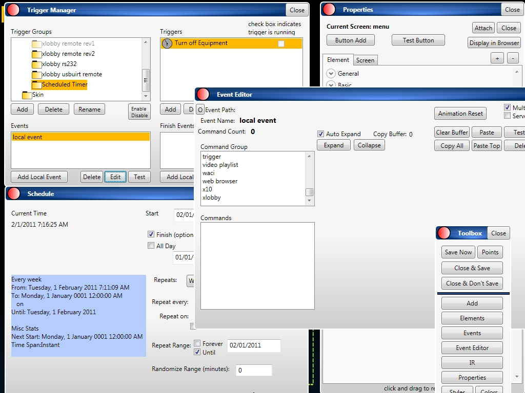

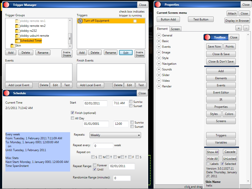

This is already in the current version of xLobby V3 using the event triggers tools. Create a new trigger group then create individual scheduled timers based on the days and times you want to schedule the event. Add a local event to the scheduled trigger then create a macro of IR or RS232 commands to send or what ever you want.
Screenshot of xLobby triggers
Screenshot of the local trigger tied to the scheduled trigger event.
Any further questions, let me know.
