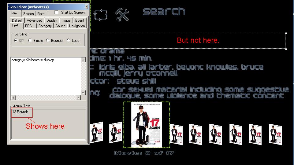

Yep, seems to only find "17", or is it "17 Again", or is it the "movie that has the same concept that's been done sooo many times in the past, and the idea has been just killed"? Either way...that's the only movie being displayed....again, and again....again....again.... :shock:
*EDIT*
Actually, it is only the coverart that isn't changing. The movie title, rating, director, cast, runtime, genre are changing per movie. The other strange thing, is that the title is shown in the skin edit "Text" window, yet it is not being display in the skin...how strange...I thought I had a text sizing issue, but it is just not showing.

HA! Mine gets stuck on "12 Rounds." Same deal... Everything seems to update except for COVERART and PREVIEW. No previews are showing up.

Looks like the variable "MovieInfo_m title" is not correctly being populated... regex in code probably needs to be changed. Anyone have intheaters plugin source?
